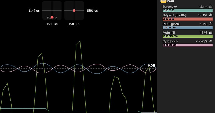

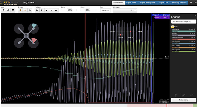

Having a quick look at the logs
The motors (I only displayed Motor 1) are going nuts, from 0% to about 70% back and forth. You can see the red line of me slowly increasing the throttle, then dropping it again. P & D (for pitch, but others the same) also going nuts.
I’ll pop out in a sec and try dropping the Master PID slider down from 1.0 to about 0.6 and see what happens. After that I’ll try increasing the filtering.
I also notice the barometer does something weird and starts to go down as I increase the throttle, before then rising after I drop the throttle and the quad climbs. Bit odd, although prob nothing to worry about right now.
I guess the question here is - is excessive PID activity causing the motors to pulsate, or are pulsating motors causing excessive PID activity?

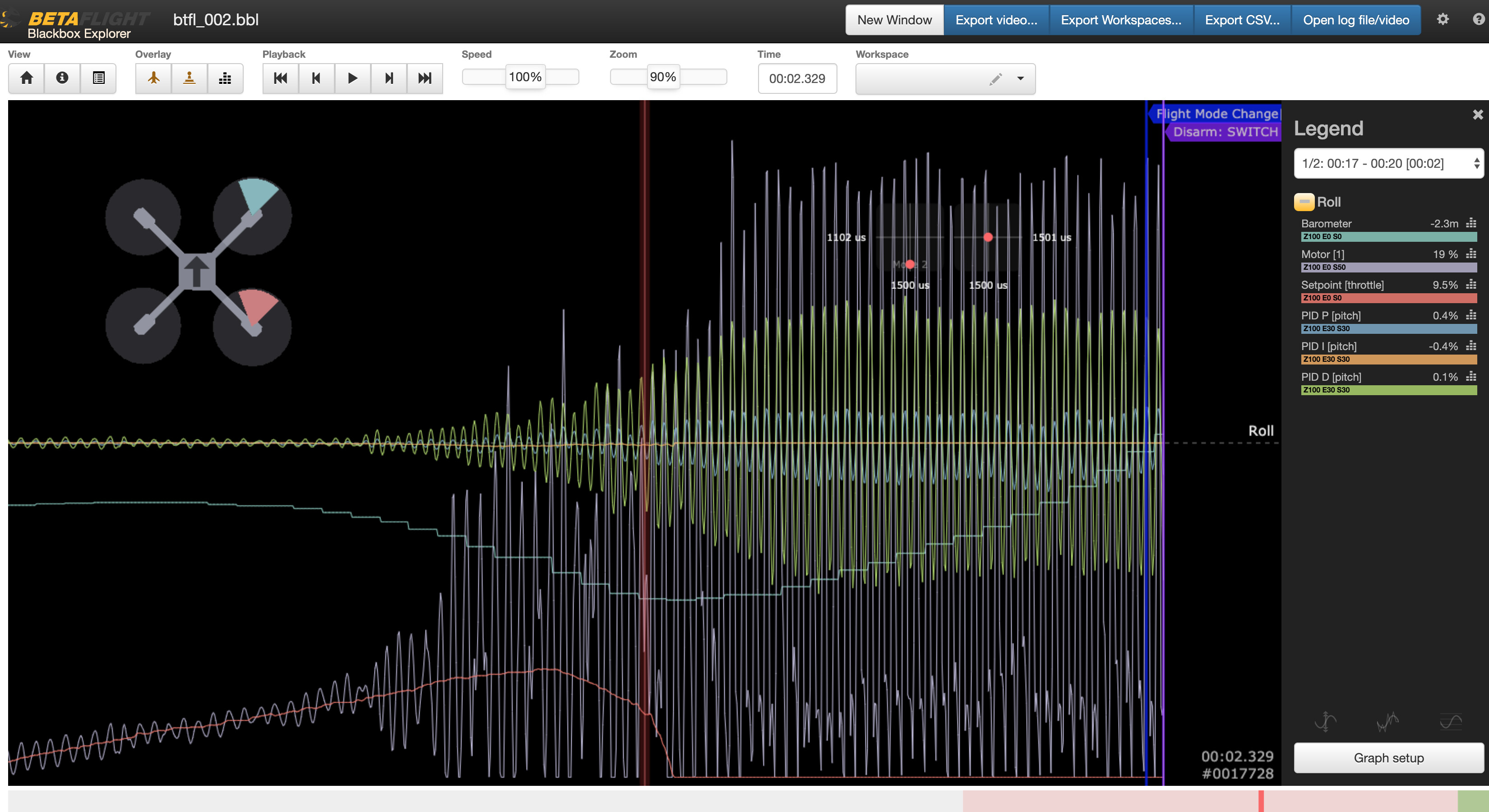

Looking at this, the P term (for pitch) is completely out of sync with gyro, constantly overcorrecting in a perpetual P-term oscillation, causing the motors work harder and harder

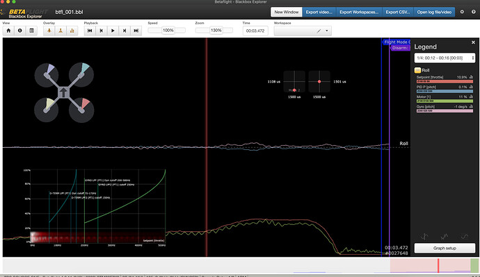

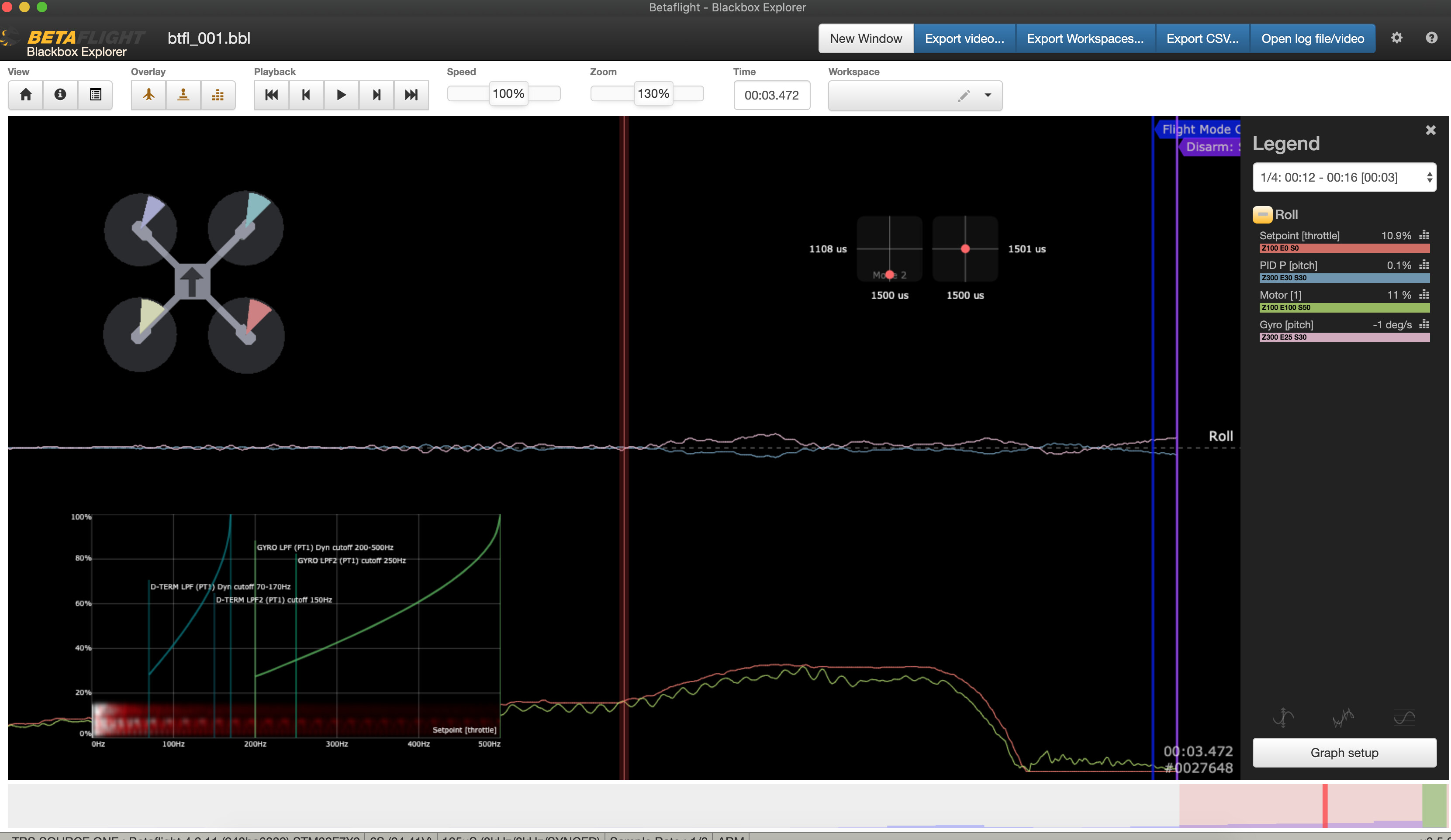

So, master PID gain slider down to 0.6
At low throttle things start to look a bit more normal and I can hover at low throttle - yay!
There are some motor oscillations going on though

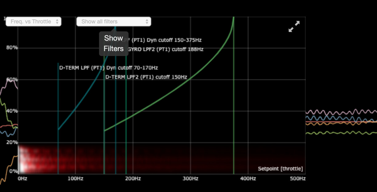

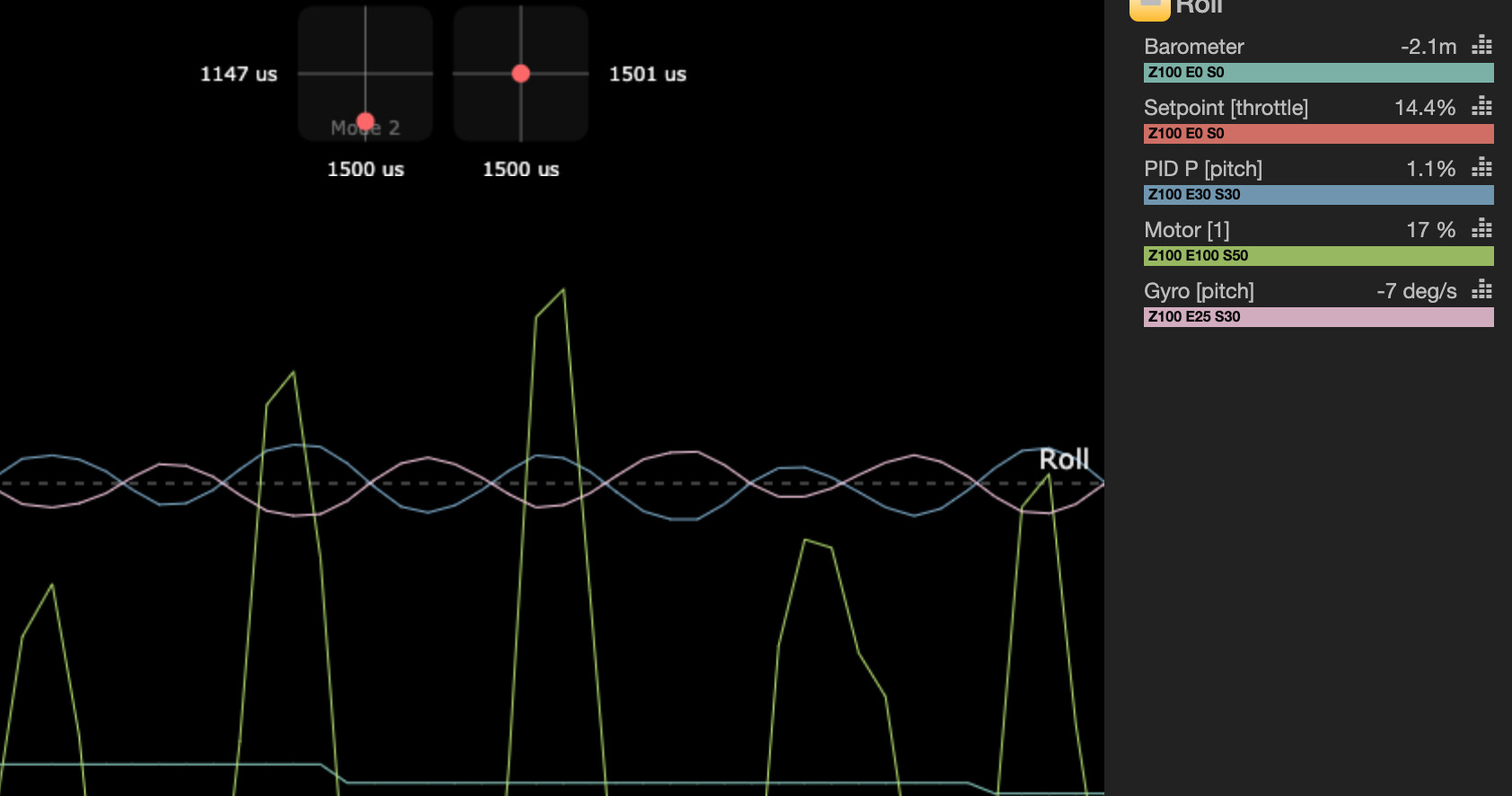

This repeating harmonic vibrations in the bottom left graph concern me a little too and strike me as something that could be eliminated using the gyro filtering if I understood it well enough. From here on I think I’m going to have to continue to tweak things in a big open field because I can’t really test anything more than 16% hover throttle in my garden. 16%!!

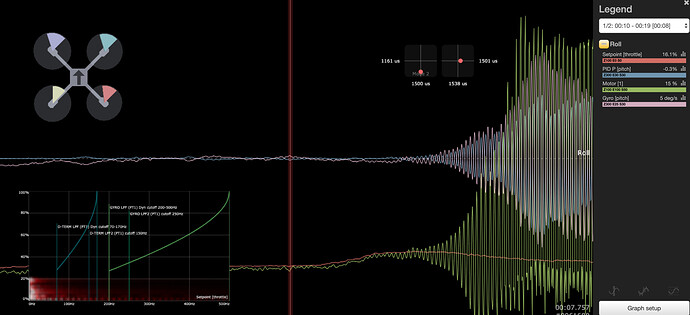

Tried the Gemfan 7040 props.
Hovers at very light throttle, then as you increase the throttle a touch it goes wild and shoots up again
Also tried dropping the gyro filter slider to 0.75 (more filtering), still does the same thing.
There’s definitely some vibration somewhere- that little bottom left graph shows something happening at very clear multiples of about 20hz.

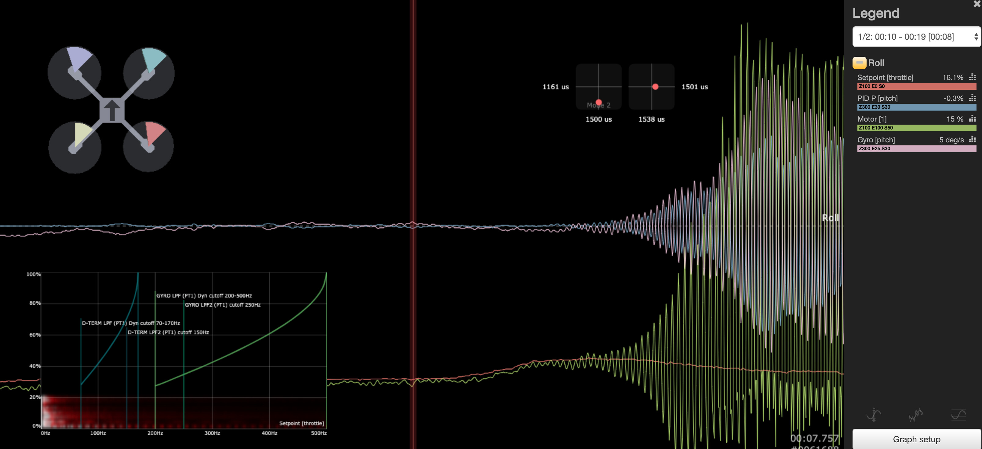

Another quick hover - baro off and PID slider down to 0.5 (I know, I know, two changes at once). Much more stable, but I’m sure this is the effect of the PIDs. Still some oscillations in the logs, but not as bad as before.
Less obvious repeating vibrations than before. I’m sure they’re a result of excessive P-Term. The motors have so much torque, they don’t need anywhere near as much P to correct for errors.

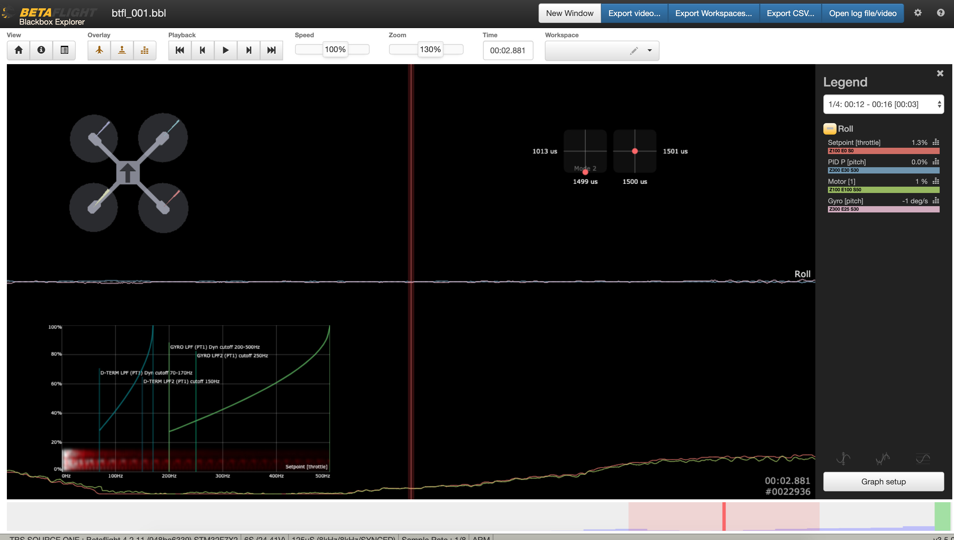

Cheers will do. I did another quick hover now - noticed that as well as the master gain slider which is now down to 0.5, there is also the P/D gain slider which I took down from 1.0 to 0.75. The trace looks a lot smoother now, although still some minor oscillations. More to come when I get some time - probably in the week now.

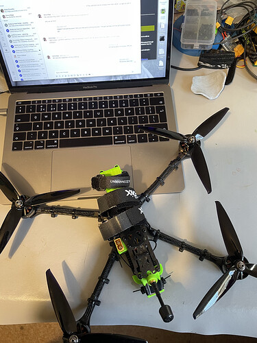

Here’s a thought…
I’ve seen mention of the TBS Source One 7" being available in deadcat or standard X configs. I’ve only ever seen the 7" arms being sold as a single item from UK stockists though, never seen an option for different configs
When assembling the frame, I figured you could flip the arms around to give slightly different geometries, since there is a slight bend in the arms where they mount, so you can have them pointing forwards a bit or backwards a bit. Two of the arms also have slightly more bend than the other two. I arranged the arms so the front arms bend back a lot to get them out of view and the rear arms bend back slightly - giving a soft of deadcat configuration, but not as obviously so as other setups I’ve seen.
Looking at the photo below, the front and rear props come very close to each other, where as side-to-side there is a large gap
What are the odds I’ve assembled the frame wrong and this uneven front to back vs side to side layout is confusing the hell out of the PID routine? If nothing else, increasing the spacing from front to back props would reduce the pitch authority and give the drone more pitch inertia, reducing the chances of PID overshoot. Maybe.
Unlikely, I’ve messed with various frame configurations away from a true X and never had any issues.
Always seem to compensate for what I imagine is not a big change considering the torques involved
IMHO
Steve :slightly_smiling_face:
Yeah I think you’re right, now I’ve had a chance to ponder it a bit more.

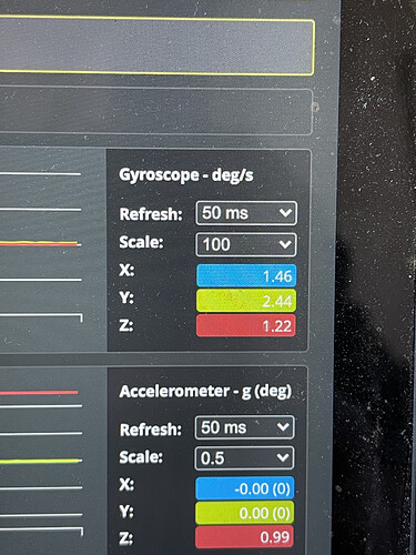

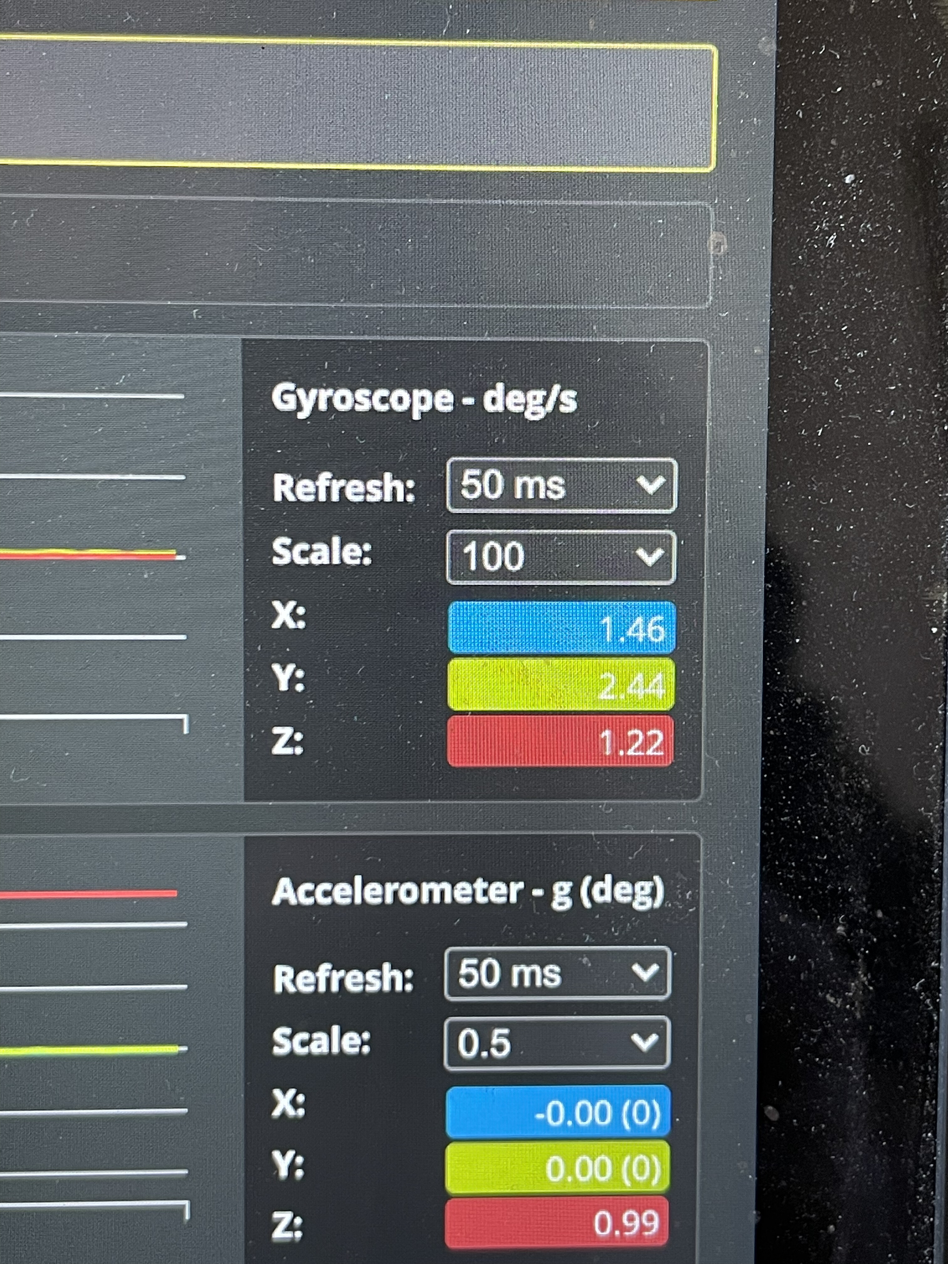

Who was it above that mentioned checking the gyro trace in BF configurator? Just had a look now, it’s flickering a lot between 0 and these sorts of numbers
Could it be a duff gyro? I need to plug in my Nazgul and see whether that level of flicker is normal.
Edit: The Nazgul flickers up to about 0.5. But then I plugged the 7" back in and it’s only also flickering to about 0.5 now. So perhaps not this. Grrrr
