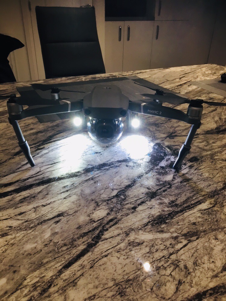

Well I put them on my MP2, on the front legs and it went haywire. It seemed to sense an obstacle in the dark and set off backwards trying to avoid an obstacle every time the strobes flashed. Sooo I repositioned them so that I have just one flashing light underneath the aircraft, at least I can still see her in the dark.
After being a bit shaken by the event, I decided to but some PGYTECH extended legs which include powerful Cree lights that attach to the rear legs. I did take a photo but they were so bright that it came out as a huge bright blob in the night sky. But at 100 feet away, they were blooming bright!!!
I will try and get a decent photo.
Here we go.
A few photos of the pgytech landing gear and lights fitted to the MP2. I really recommend these, for a couple of reasons.
They fit properly, use AAA battery which can be bought anywhere, have two levels of brightness, (bright and ‘holy crap my retina has burnt out’) as well as a 3rd which is a strobe effect.

Im a big fan of PGYTech stuff as well. As you say, looks quality and almost looks “original equipment”.
Ive just ordered the same lights for the Air - to have my first “dusk” flight.
Neat solution to combine the leg extenders and lights on the M2
do you thing they are worth the money??
The pgytech are worth the money. A couple of reasons. They fit superbly and securely and look like part of the drone.
They raise your drone up and prevent damage to the camera gimbal.
The lights are powered by AAA batteries which are available everywhere, even rechargeable ones if you are an environmentalist. Have 3 modes as I mentioned in previous post.
I did buy a pair of strobon strobes (see pic) which are very very good, however unless you have a 3D printer, you then have to buy a pair of carriers to securely attach them to the legs which doubles the cost. You have to recharge them (or remember to do it) cos the battery is built in. They are small and light tho, but fixing them in with Velcro doesn’t look very secure or professional.
Or to the rear arms with two cable ties for a couple of p. :wink:
