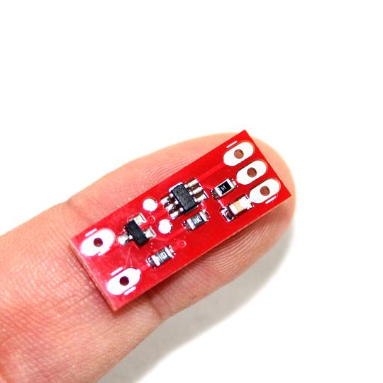

Was looking at these today. Must admit, I find it hard to see either of my drones past 200m or so. They seem really effective. I weighed my MM2 at 241g with battery and props. According to Flytron, they’re 4g a pop. So 2 of these Strobon standalones would put me at the limit.
Granted, 8g isn’t a lot, but half of that weight is the 3.7v 70mAh lipo batteries. An alternative idea would be to tap into the unused 3.6v pin output on the MM2 power and ESC board.
From this (above) going to the Strobon SE v2 Navigation Strobe Controller (below) which weighs 0.3g and can drive/control multiple LEDs.
From the controller routed inside the front arms to where the antenna wires come out (underneath the front arms, where it meets the front leg), and have a pair of 0.5g Strobon 3W Power LEDs (one green, one red?) mounted on the legs held in place with grey heat shrink :thinking:
254_540x
Approx 2g of wiring would required too. That would make it about 3.3g in total for a pair of strobes that runs off the drone battery. There are probably a shed load of reasons not to do it, but being grounded … I have a lot of time to think up daft ideas :sweat_smile:

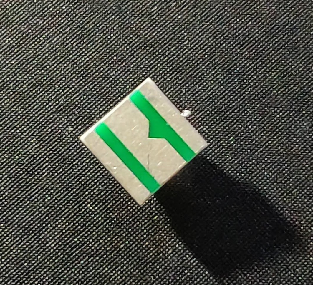

I also purchased some of the CREE Xlamp XP-E2’s from RS Components, to use with Strobon SE v2 Navigation Strobe Controller. Flytron confirmed they’d work, as they use the XP-E (predecessor) with the standalone. What I didn’t realise is how small these are.
