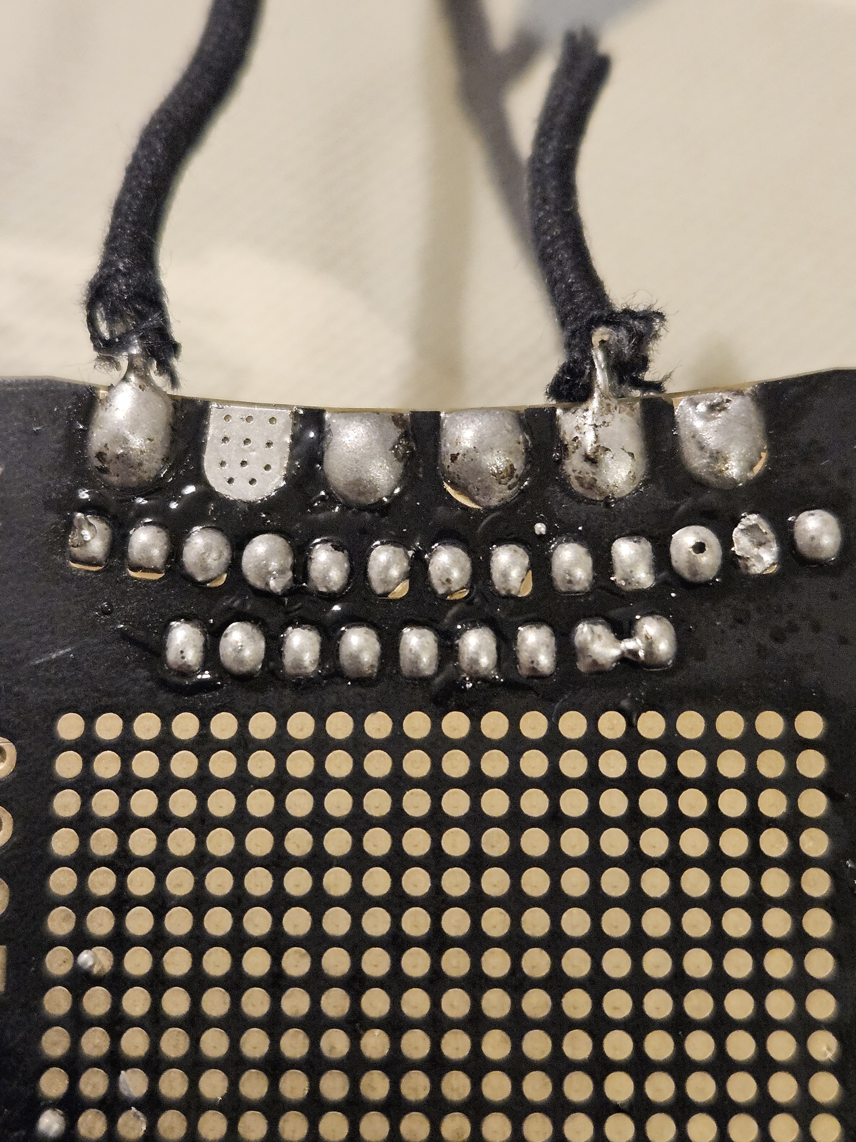

Evening. I’m going to build a new quad in a SpeedyBee Mario 5 DC frame and have been practicing my soldering on a practice board.
So far the results are shocking :sob:.
Every pad I’ve tinned is dull, not a shiny blob in sight. I’ve tried 3 different solder wires, two different 63/37 and one mystery solder wire. All go dull, not shiny. I’m using a cheap 60w amazon iron so I know my kit is bargain basement stuff.
I’ve used a flux pen on every pad, tried high and low temperatures.
Is it more likely that my iron is junk and the temperature control is BS, overhearing the solder then 3 different solder all refusing to shine?
I’ve even lifted some pads right off the board, so I don’t dare go near my speedybee stack with the iron yet.
Where is the goto place to buy decent solder and other supplies?

That’s pretty much exactly what I’ve been doing. There are some horrors on this board but what’s common across all of them is the dullness.
Ignore the wire I’ve used, that’s some leftover from a previous guitar project.
They will go dull after a few seconds as the oxygen reacts with the lead.
That 1st wire joint looks fine :+1:t2: minus the couple of bridged pads and the not fully flowed pads.
The 2nd wire joint needs reflowing and will be fine also :+1:t2:
Bit of IPA to clean up the flux and they will be fine :+1:t2:

The wires need to be pre-tinned before you attempt the joint, this aids heat flow and is also another source of flux to the joint (provided you didn’t burn it off with leaving the heat on too long)
:smile:
The surface colour of the solder when it cools is irrelevant, despite some claims to the contrary. Industrially produced PCBs are factory made by machines under ideal conditions, which makes them look pretty.

Looks like the cheap amazon solder was the reason for the dullness. I got some Duratool 60/40 and it’s instantly shinier.
Now to keep practicing and get the temperature and timing right so I don’t have any burnt spots in the solder.

In the end I’ve found my cheap amazon iron to be just about fine.
The game changer was buying decent branded 60/40 solder from somewhere other than Amazon.
