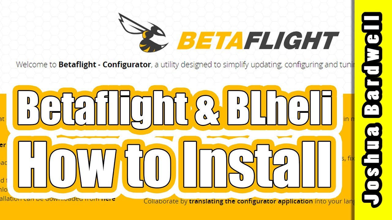

Don’t know if this might help by Bardwell (you probably already seen it)

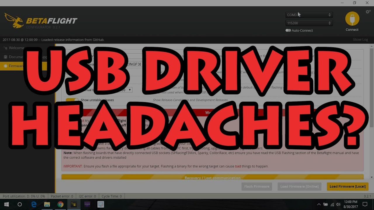

The other thing that can help (I have not tried this myself, was about to but then found out about the usb cable) is ImpulseRC Driver Fixer
It was recommended in a video by Albert Kim but I can’t find the video on YouTube now. If I find it again I’ll link to it
Here’s the vid I was talking about by Albert Kim
