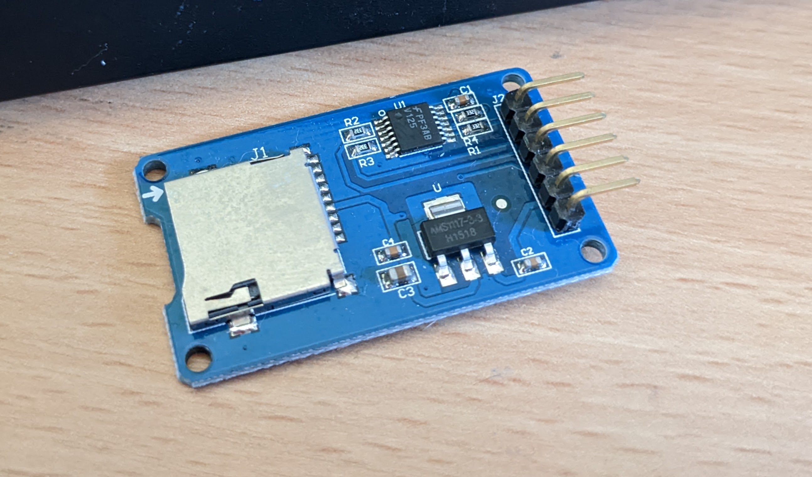

No black box… Out of interested do you just wire an SD card thingy to a UART for that, as I have (for a reason I have no idea why) an SD card reader/writer for an arduino in front of me… Will dig out the DVR later, and see if can get online to see. I’m sure I’ll have DVR footage…

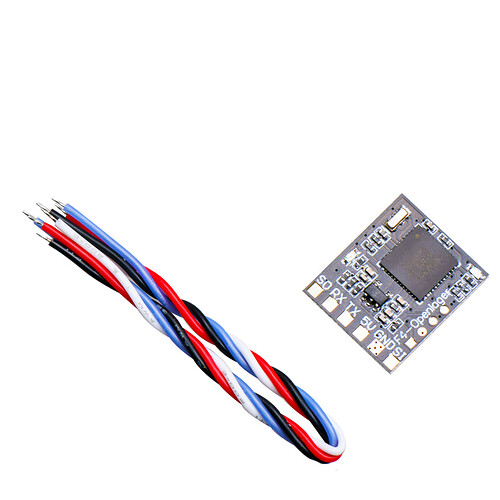

So, it’s a little quad, right? So you probably want to use the onboard flash black box, assuming the FC has one. It probably doesn’t.
If not then you need an external one… I have one of these on my Badger and it works.

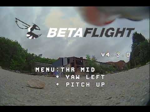

Here’s the footage
Skip to 1:50 if you want to see the issues. Watch with no sound as it’s awful! Also the video feed there is weird, same quad in fields is fine! I was doing simple circuits to see how it was…
