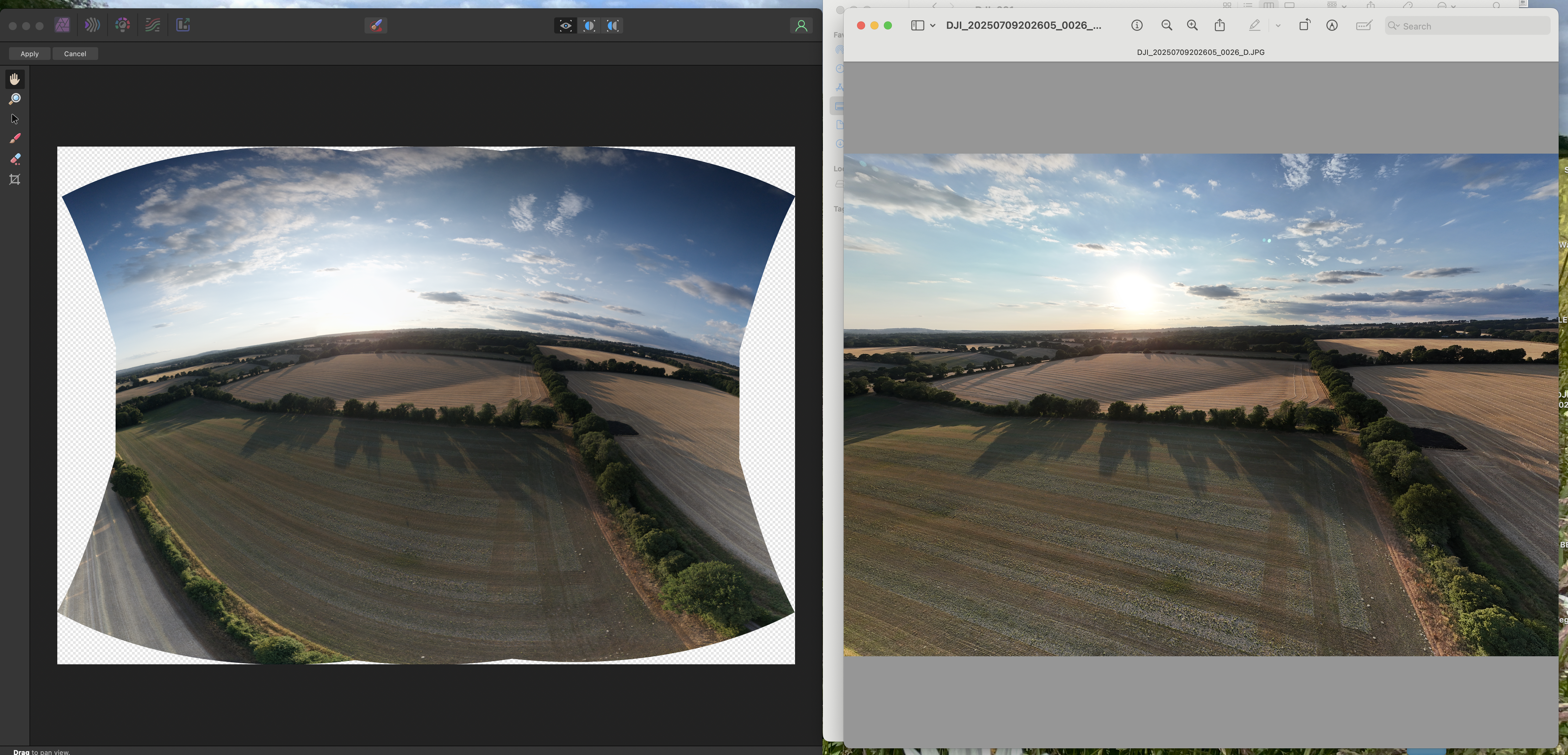

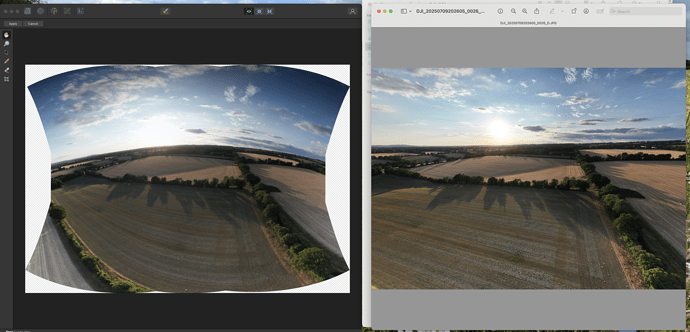

I am having a continued frustration with something. When I generate wide-angle images, using the Panorama tool on the 4 Pro, whilst the jpegs always have straight horizons, ‘sometimes’ the DNG files, when stitched together in Affinity 2, come out with a heavily curved horizon and heavily clipped. The separate DNG file images themselves are all straight and evenly exposed but going through the panorama tool in Affinity2 ruins them. The Mini 4 Pro’s software always produces a jpegs properly exposed and straight. Does anyone else have this issue. I’ve asked Affinity about this and they have been less than helpful, saying I should convert all the DNG files to tiffs first. I’ve tried this and its made no difference. The other issue is the poor quality of the stitching of some 180 panoramas in Affinity2. With a clear sky, the stitching is visible and very difficult to remove, rendering some images useless. Left image is created by Panorama tool in Affinity2, right image by DJi Mini 4 pro.

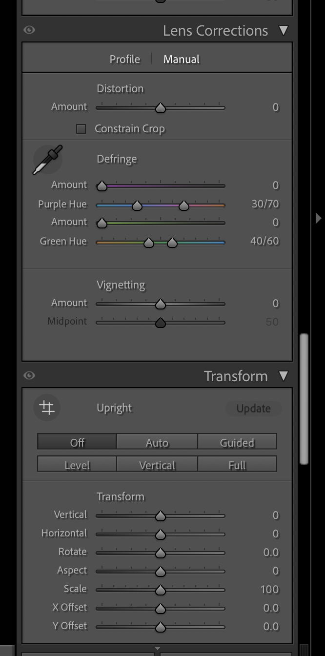

I cant comment on Affinity 2 but i can certainly comment on Lightroom. Basically, in the Develop module, the 2 sections on the right hand side are the adjustment sections i use for correcting distorted images (verticals, horizons etc). Its easy peasy to use - more often than not, i just select the auto function then tweak the sliders manually

It’s using a spherical projection and the camera is pointing down so the horizon will be curved. I’ve not use Affinity for panos, is there a projection setting?
Cylindrical projection would be OK, or a linear one if it is’nt too wide.
Google says: Affinity Photo does not offer a direct, user-selectable Cylindrical projection option during panorama stitching. However, it does use a cylindrical projection by default for panoramas

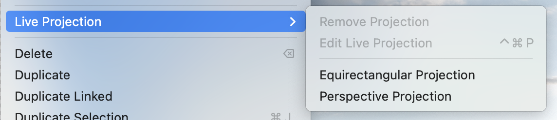

Thanks for the heads up on that. In Equirectangular, it distorts the image totally and in Perspective, it brings up a grid, which can then be manipulated, a bit like the Mesh warp tool, but no much help. The Mesh Warp tool is the only thing I’ve found thus far, that enables me to draw the horizon down to a level plane. I think what is probably happening, is that when I point the camera down to create a ‘thirds’ perspective, as you say, the camera points at the ground and distorts the horizon.
