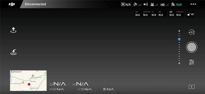

Just a mock up I’ve done of what the GO4 (and others) could be in the future. Quite liking this concept…
Adding a live feed of flight tracker to the map section.
Could this work?

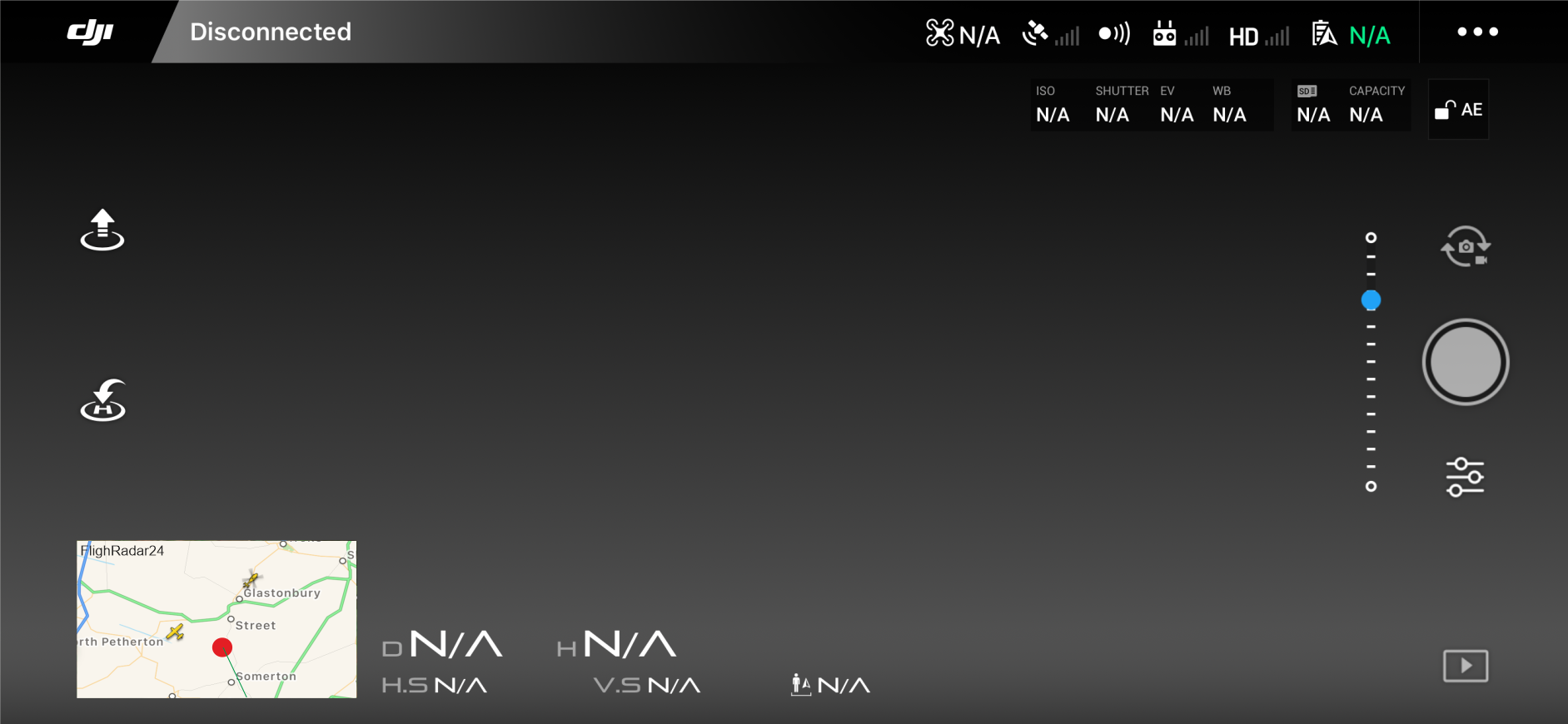

Could this work?
hell, that would be brilliant if they could do that.
Would it not enable us to fly further & safer too
Is it a case of “FlightRadar” being able to be overlaid onto the Go4 App screen?, or am I reading into this to much?
Yeah definitely, phones need a PIP (picture in picture) mode
It’s something I’m sure will be common place as ADS-B is added to consumer drones and more importantly if it becomes mandatory for all full-size aircraft.
The problem with Flightradar24 and similar APPs is that they are reliant on ADSB receivers connected to the internet and able to receive the data transmissions of aircraft in your area. These are generally run by the same aircraft hobbyists who like listening to aircraft. That and most small privately owned aircraft, the ones most likely to be flying at low altitudes, don’t actually carry ADS-B equipment. Similar with military aircraft.
Ardupilot’s Mission Planner, and Universal Ground Control System (UGCS) which works with all DJI drones, have the provision to handle ADS-B data when a suitable transponder is mounted to the drone.
I have experimented with ADS-B in the past, using cheap digital TV USB dongles configured as UHF Software Defined Radios. Even from my location I was able to monitor aircraft manoeuvres as far South as Birmingham, when the aircraft was at 30,000ft, but unable to see aircraft on the runway at Leeds and Bradford Airport, even though I could hear them, because these transmissions rely on line of sight and the runway is on the other side of a hill from me.

I’ve only just downloaded this tracker app and the first thing I noticed was helicopters flying around, which normally tend to fly reasonably low. My thoughts were, if it picks up those, in my opinion our worst threat then it can’t be that bad. It would really be a case of having all aircraft fitted with this technology so non slip through the radar so to speak.
You are fortunate to have someone in your area who is able to receive the ADSB transmission and pass that to the Flightradar24 servers. More often than not if I follow an aircraft on Flightradar24 approaching LBA it invariably crashes into Leeds Town Hall as it becomes too low for the ADSB signal to be received and the software just maintains a best guess heading.

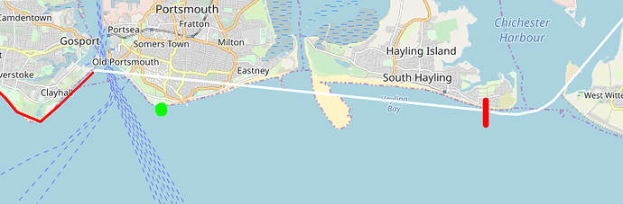

I, and others on GADC, have flown this stretch of coast … and this chopper was AWOL for the majority of it (after the red mark up to where the track reappeared in red), and flew over beach by me (green blob) sufficiently low/close that I could see the crew.
I wasn’t flying that day and, following ADSB discussions on here, thought I’d take a shufty at the feed whilst at a location I’d often flown.
Several other light fixed-wing aircraft were about that day, low over the sea, that never appeared on ADSB either.
