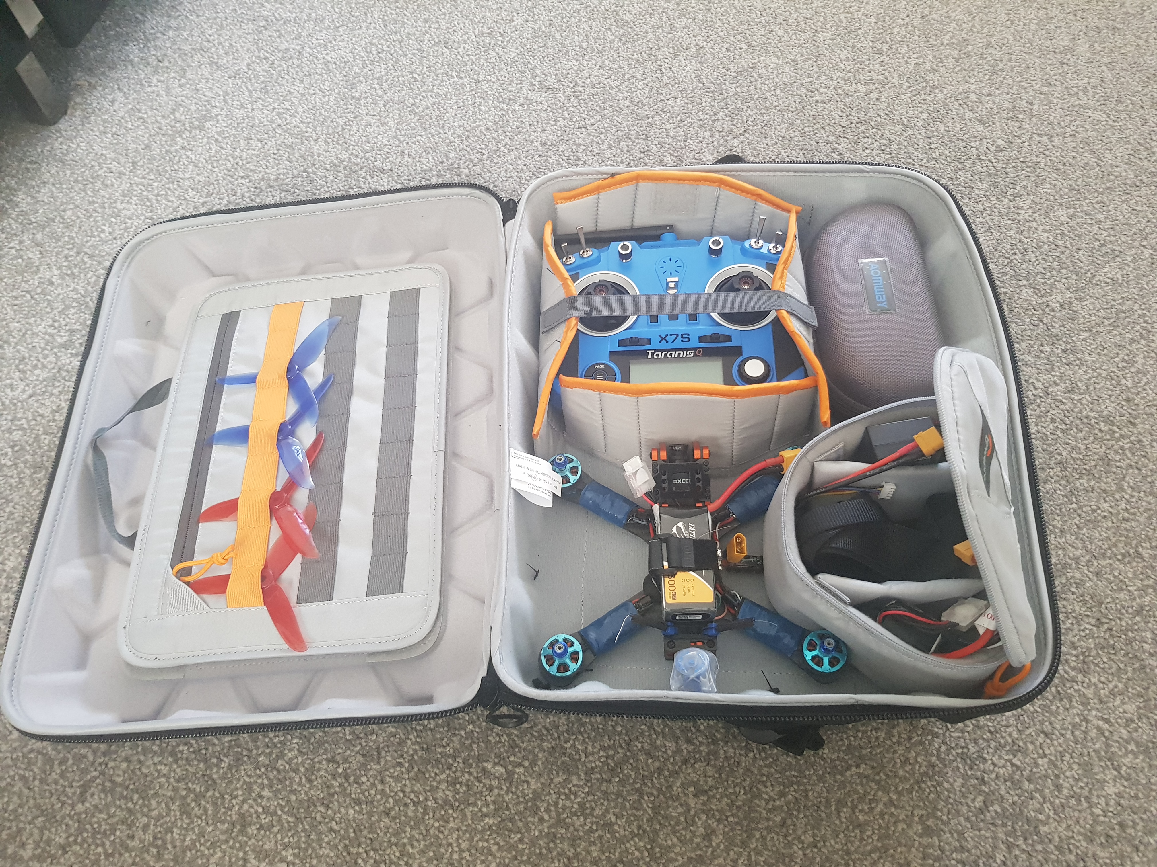

Well the CS300 arrived and not as big as I expected.
It’s actually a really good size for a racing quad.
Everything seems secure using only the included dividers, I dont think I’ll need to make foam inserts.

That looks perfect, I take the quad wont fit in with the props on ?
Got it from, https://www.t9hobbysport.com/
Props need to come off. Could probably leave them on with a smaller TX though
haha, Thought I’d seed that thought ![]()
That’s a decent looking case @callum
Yeah I thought so too mate. Seemed not bad for the price, a bit square feeling on your back but gets the job done.
